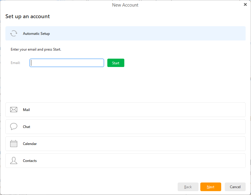

When you add your email account to eM Client, you’ve got a couple of options for account setup: automatic or manual. Users who select a manual setup in eM Client will need to know their POP3 or IMAP protocol information in order to add their account.

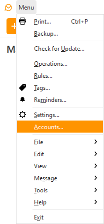

  • After clicking Menu > Accounts > Add Account, the following window will appear:
    eM Client: Chat easily inside your mail app
    Add account menu option (left) and the account setup window (right)

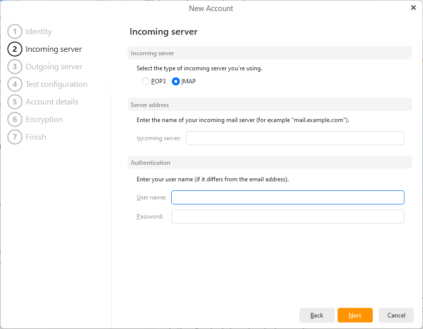

  • Select Mail > Other. After you add the name of your email account in the Identity page, the Incoming Server page will allow you to add your POP3 or IMAP protocol information.
    eM Client: Chat easily inside your mail app Incoming server page shown above
  • Add the name of your server for the Incoming and Outgoing server pages. The name of the server might include the domain or the name of the protocol. For example, if you use Gmail, you could add pop.gmail.com, imap.gmail.com, or smtp.gmail.com. If you are unsure about the name of your server, go to your mail provider’s website and check to see what you should use.
  • Once this process has been completed, the test configuration page will ensure that the IMAP or POP3 and SMTP protocols are effectively communicating between your email account’s mail server and eM Client.
