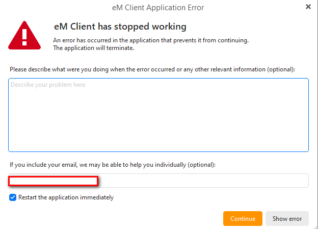

Don’t hesitate to reach out even if you only see the crash window. Use the “Show error” button in the crash window and send it to the address mentioned above as a text file. Or use the window itself to send us the report; if you just want to let us know about the problem, but you are not seeking direct help for the problem.

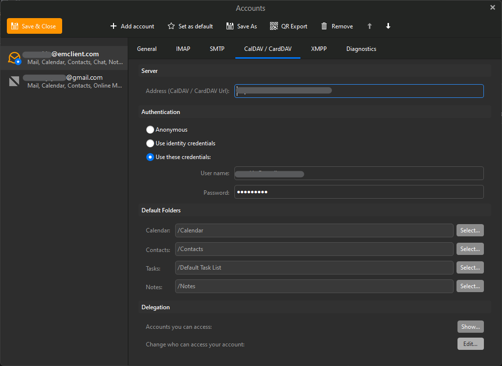

Double check to make sure that the calendar service provider hasn’t updated the calendar URL. Update the URL in Menu > Accounts > *account in question* > CalDAV (or Exchange) and if necessary, remove and add the account again. Accounts that do not have a calendar will lack CalDAV or Exchange tab.
eM Client: Accounts Settings
Example of CalDAV account in eM Client

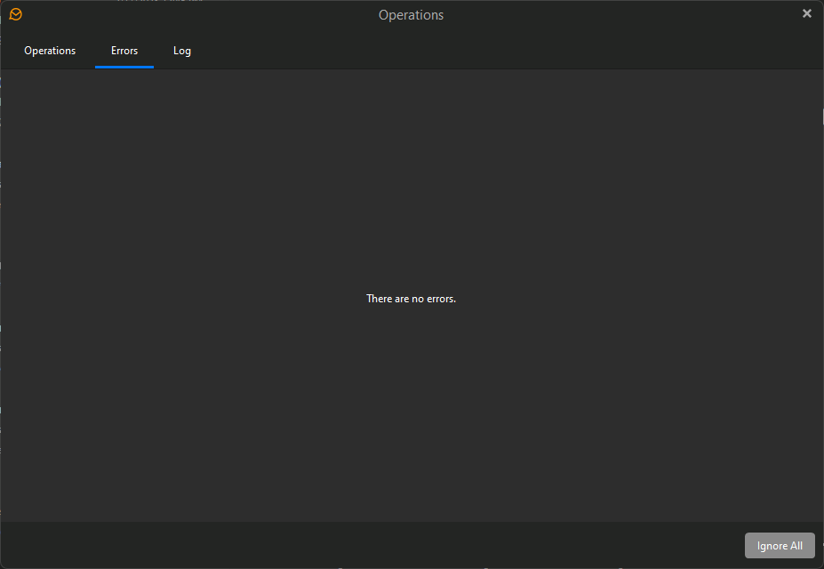

Repair didn’t help? Verify that your Internet connection is OK and check Menu > Operations for errors. If there are errors: copy the log and send it to us.
If there are no errors follow these steps:

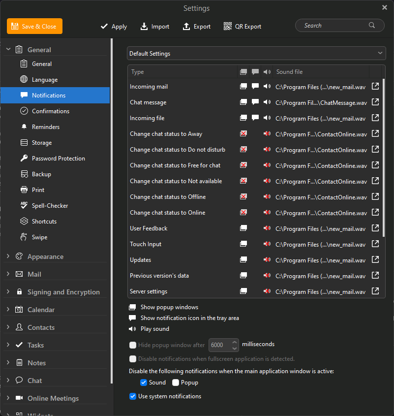

If there is a chance that the settings were edited in the past, it’s worth double checking them in Menu > Settings > General > Notifications.
Deactivated pop-ups and sounds could result in missing important notifications. If the system notifications are enabled in eM Client, but disabled in Windows; no notifications will be displayed.
Notification settings in eM Client Notification settings in eM Client
Check to make sure that notifications are enabled for eM Client in Windows settings. If you’re still not seeing your notifications, see if you have Focus Assist turned on. Focus Assist mutes some notifications on your device. Read the Microsoft article to learn about how Focus Assist works.

A corrupted database after a crash usually generates a log file so you can provide us with the information about the problem you’re experiencing. The crash report window will ask you to describe the issue. Include your email address for a follow-up and send us the report with the database log.
Our team will analyze whether or not the database can be recovered and what caused it to fail. Not only will these reports help rectify the issue for you - they will also help us improve the app for the entire user base of eM Client.

If eM Client is the only app that exhibits connection issues and it has already been added to antivirus exceptions (If not, check how to add the app to exceptions), and there’s no other active VPN; please provide us with a copy of the operations log.
To access the operations log, go to: Menu > Operations > Log, click on the “Copy Log” button and paste the contents in the text file so we can investigate it.

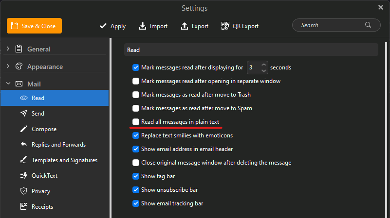

If your messages aren’t displayed properly, it’s time to change your settings. Check to make sure that you have not enabled plain-text messages in Menu > Settings > Mail > Read. Try deactivating this option, click Apply, and see if the message(s) are now displayed correctly in eM Client’s message preview pane.
Read settings in eM Client

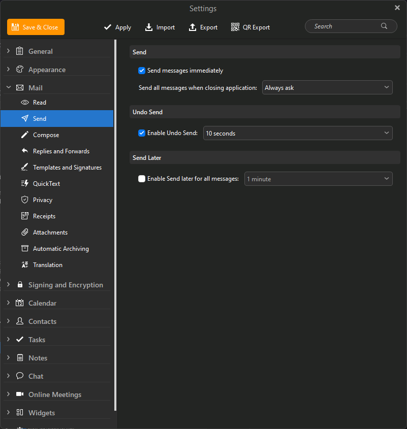

eM Client has a feature called “Send Later,” which allows you to delay all outgoing messages in case you might change your mind and decide to cancel the send or add some last-minute edits. You can find this feature in Menu > Settings > Mail > Send.
If it is enabled, turn it off, and see if the messages are being sent immediately. Double-check other “Send” settings as well since they can affect how eM Client sends messages.
eM Client Send settings

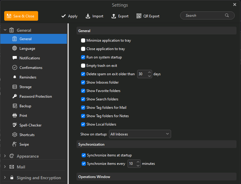

Another setting that can affect sending and receiving is the sync interval and startup sync. Try reducing it. If you increased it in the past, make sure the option “Synchronize items at startup” is enabled. Then, restart the app and see the results.
Global Sync settings
